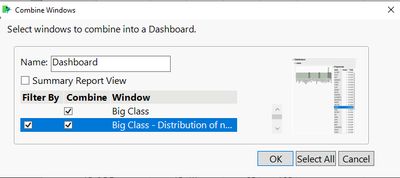

Concerning issues with interactive HTML and filters, most of the post refer to the issue that a Local Data filter is disables - with the easy solution: disable Include mode.
The Data Filter window is not interacting in HTML
Interactive HTML with filter
JMP16 HTML Filter Disabled
Interactive HTML reports - local data filters not working in JMP 16?
Need help. Got some error during create interactive HTML file
JMP16 Graph Builder publish in HTML not interactive
There is a similar issue with "filter by" or "filter + 1 dashboard", where one graph is used to filter the other graphs in the Dashboard.
In this post:
 @John_Powell_JMP provided a workaround:
replace the selection graph with a local data filter and disable include mode.
Till 2020, selection filters have not been implemented in Interactive HTML. Therefore, a request was added for the feature request being used internally to track it.
Is it now possible to use selection filters in interactive HTML?

Hi @hogi ,
The answer is no, but I will interpret your inquiry as an additional vote in the internal wish list to implement this capability in Interactive HTML in a future version of JMP.
The selection filter capability does not have a show mode like the local data filter. It is designed to include the rows selected by the graph used as a selection filter in other graphs shown in the dashboard. There will not be a mode that you can change to make it possible to support in stand-alone Interactive HTML files. It will require a server to process the inclusions/exclusions.  This means that when made available, it will only function in JMP Live.
If you would like the selection filter capability to offer a mode that shows/hides data displayed in other graphs, please create a wish in the JMP Community Wish List:   https://community.jmp.com/t5/JMP-Wish-List/idb-p/jmp-wish-list
