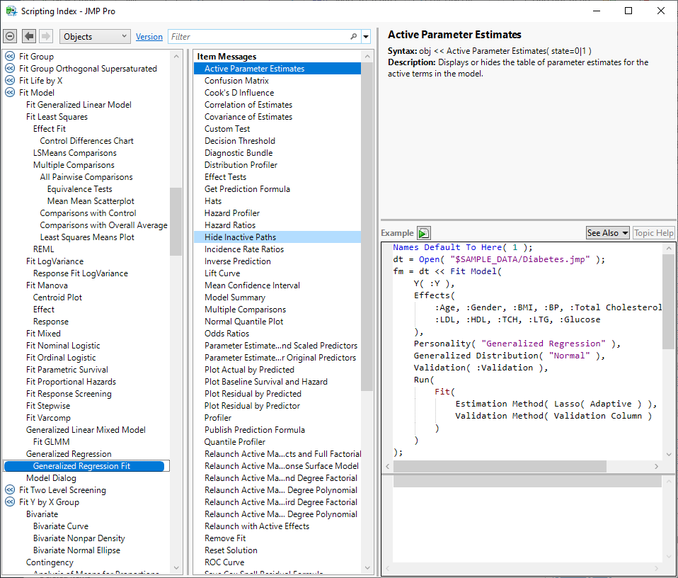

Select Help > Scripting Index. Select objects using the drop-down menu at the top left. Search the left-most list for Generalized Regression Fit. Here you will find the protocol for this object. It will tell you all the messages that can be used to script this platform.

Thanks! That was a very good first hint! The example script is a good starting point!
