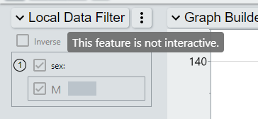

There are some features of interactive Dashboards which are not implemented in interactive HTML yet.
If such a feature is present in a Dashboard, the exported HTML file will no be interactive and a message is displayed:
A question that arises very often: why is a local data filter not interactive:
The Data Filter window is not interacting in HTML
JMP16 HTML Filter Disabled
Interactive HTML reports - local data filters not working in JMP 16?
Interactive HTML & JMP report: different behavior, different values
Need help. Got some error during create interactive HTML file
JMP16 Graph Builder publish in HTML not interactive
an the easy solution: it's due to the "Include" functionality: the graph adjusts (fit lins, X/Y Groups, plot region etc.)  to the displayed data points.
And at the moment, such an interactive adjustment is not yet possible in interactive HTML.
A kind of solution: disable the Include mode.

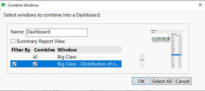

There is a similar issue with "filter by" or "filter + 1 dashboard", where one graph is used to filter the other graphs in the Dashboard.
In this post:
Filtered data function didn't work for JMP 14 dashboard interactive HTML report
 @John_Powell_JMP provided a workaround: replace the selection graph with a local data filter and disable include mode.
Till 2020, selection filters have not been implemented in Interactive HTML. when @josh_markwordt reported that  a request was added for the feature request being used internally to track it.
Unfortunately, there were too few votes to support the feature in the internal tracking list, such that selection filters are not yet possible in interactive HTML:

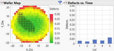

The "workaround" with Local Data Filter is very useful for simple filter.
Here is an example where "filter by" is much more useful than a Local Data Filter:
(although I admit, this kind of plotting is not the most useful for the chosen dataset :)
dt = Open( "$SAMPLE_DATA/Wafer Stacked.jmp" );
New Window( "Wafer Stacked - Dashboard",
	Data Filter Context Box(
		H List Box(
			Data Filter Source Box(
				dt << Graph Builder(
					Size( 460, 424 ),
					Show Control Panel( 0 ),
					Fit to Window,
					Summary Statistic( "Median" ),
					Variables( X( :X_Die ), Y( :Y_Die ), Color( :Defects ) ),
					Elements( Heatmap( X, Y, Legend( 5 ) ) )
				Lock Scales( 1 ),
				Variables( X( :Lot ), Y( :Defects ) ),
				Elements( Bar( X, Y, , Summary Statistic( "Mean" ) ) ),
				SendToReport(
					Dispatch(
						"Defects",
						ScaleBox,
						{Min( 0 ), Max( 0.4 )}
