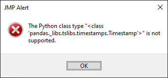

I have a pandas data frame which has been imported from a database. One column is in the datetime64[ns] type. I want to copy the dataframe into a JMP data table, however the datatime data is lost (missing values) when using the method in this post: https://community.jmp.com/t5/JMPer-Cable/New-in-JMP-18-Python-jmp-DataTable-and-pandas-DataFrame/ba-...

A couple of workarounds are to either change the datetime to a string then use Parse Date() in a new column, or concert the datetime to an integer, add the necessary offset and then reformat it in the JMP table.

I think both of those methods are ok.JMP doesn't recognize the timestamp which I think you did notice)
You can also do direct conversion (I think this might use temporary .csv)

Thanks @jthi. The Python Get() method does seem to save a temporary .csv file. I'll use the workarounds for now, but it would be nice to have a more efficient built-in way of copying pandas dataframes to JMP tables.
