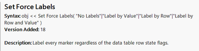

very new, thanks for this info - especially with No Labels it can be really useful!!

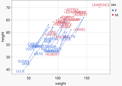

For Label Offset, I couldn't find a lot of documentation  - seems to be no functionality which is intended to be used by users?
Interesting:
- the x /y coordinates just seem to be used for double checking. This can be used to simplify the command:
just provide wrong values for MALE to get rid of them.
- What coordinate system is used for the offsets? a constant offset doesn't result in a constant shift for each label.
LabelPosOffsets = Expr(Label Offset());
For Each row(
	Insert Into(LabelPosOffsets,Eval List({row() - 1, -100,100,:weight+if( sex=="F", 0,1),:height}))
