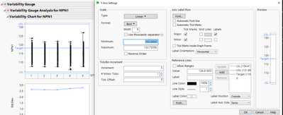

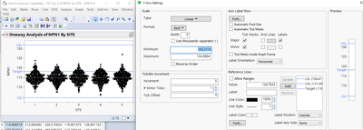

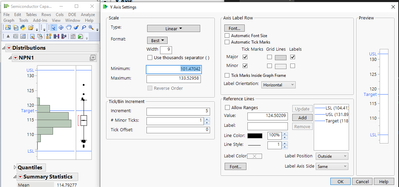

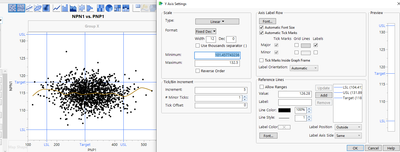

Some platforms use ref lines and some use graphic scripts for this.
Distribution, Graph Builder, One Way, Variability Chart - use ref lines

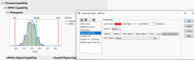

Process Capability histogram - uses Graphic Script:
I will only handle the ref lines:
