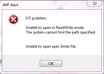

jay_S
Level II
Re: Importing Spec Limits
I think it is my pc that is the problem. Your script looks like it should work and works on your pc. i downloaded your sample tables but on my machine it gives an error/Alert. It looks as your solution works but something else is happening. I think i need to fix the I/O first before im able to implement your solution.
txnelson
Regardless if you can open the sample data tables or not, the code that I included can be cut an pasted into your JMP session, with the knowledge that it works.  So if you take your own data table and limits table, and the code doesn't work for you, then you need to look towards your data for the issue.
Jim

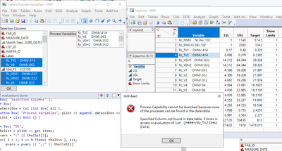

Chily
Level III
Hi Txnelson,
I try to use your script to run import my limit file but occur error. (attach my limit spec file)
it looks long variable name or character '/' issue, could you help? Thank you.
Regards,Chily
jthi
This is fairly old script (and post) and depending on what you are trying to do in the end defines how to modify it (or maybe you should use other script completely or possibly the add-in provided).
With the add-in you will have to change Variable columns modeling type from Unstructured Text to Nominal
Below is one fairly quick modification which should work if you have JMP16+ for the script (modifications done to lines 24 and 26):
Names Default To Here( 1 );
// Select the data table and open it
path = Pick File( "Select Data Table" );
dt = Open( path );
// Select the limits table and open it
path = Pick File( "Select Limits Table" );
dt2 = Open( path );
// Point to the data table as the main table
Current Data Table( dt );
// Open a new window to select the process variables
nw = New Window( "Select Process Variables",
	Text Box( "Selection Columns" ),
	H List Box(
		datacolbox = Col List Box( all ),
		Button Box( "Process Variables", pList << append( datacolbox << get selected ) ),
		pList = List Box( {} )
	Button Box( "OK",
		thelist = plist << get items;
		pvars = ":\!"" || thelist[1] ||"\!"n";
		For( i = 2, i <= N Items( thelist ), i++,
			pvars = pvars || ", :\!"" || thelist[i] ||"\!"n";
		Eval(
			Parse(
				"obj = dt << Process Capability(
	Process Variables(" || pvars || " ),
	Spec Limits( Import Spec Limits( dt2 ) )
	nw << close window;
-Jarmo
Chily
Level III
Thank you, jthi. It works well by your modified script~

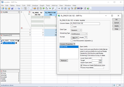

Is there any script to load limit file and directly save all limit to column properties?
