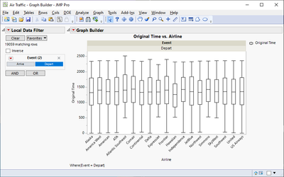

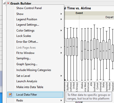

I would suggest using Local Data Filter for this instead of building list box with some custom jsl.
You can add local data filter from Toolbar
or red triangle menu
Names Default To Here(1);
dt = Open("$sample_data/Air Traffic.jmp");
gb = dt << Graph Builder(
	Size(550, 406),
	Show Control Panel(0),
	Fit to Window("Off"),
	Variables(X(:Airline), Y(:Original Time), Group X(:Event)),
	Elements(Box Plot(X, Y, Legend(19))),
	Local Data Filter(
		Add Filter(columns(:Event), Where(:Event == {"Arrive", "Depart"}))
-Jarmo
