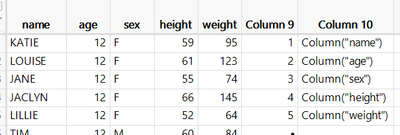

I want to use a value in a numeric column to create a reference to the same column number
I generated a column with integers that I now want to use to reference values in columns of the same number.  Column 9 contains the number indicating which column should be referenced by a formula in Column 10.  Below are several things that don't work.

Which error message is displayed when you hover over the code with the red underline?
Names Default to Here(1);
New Column( "Column 9",
	Numeric,
	Set Values( [1, 2, 3, 4, 5] )
New Column( "Column 10",
	Expression,
	Formula( Try( Column( :Column 9 ) ) )
no error:
If you don't want to retrieve the columns - but the value stored in the columns,  use As column() instead of column():

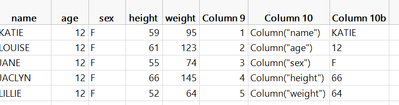

... or add a row index to Column():
  Column(col)[row()]
or          Column(col)[]
New Column( "Column 10b",
	Character,
	Formula( Try( Char( Column( :Column 9 )[Row()] ) ) )
Besides that,
  • please ensure that the calculated value matches the modelling type of the column.
    Columns 1 to 5 contain numbers and characters. This is why I added Char().
  • Column(.) will fail and the column formula will terminate. So please check if there are missing indices in Column 9

Thanks but those just give me the value already in Column 9, I want to look up the value of a different column as enumerated in Column 9 if that makes sense?

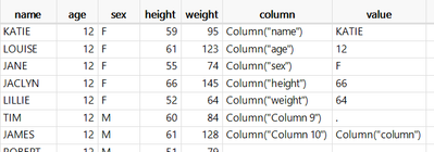

combining both approaches, let's retrieve the columns in the first step - and the values in the second step:
New Column( "column",
	Expression,
	Formula( Try( Column( Row() ), . ) ),
New Column( "value",
	Character,
	Formula( Try( Char( :column[Row()][Row()] ), "" ) ),
why :column[Row()][Row()]?
:column is column #9,
:column[row()] is the entry in the specific row of this column, e.g. Column ("sex")
and :column[row()][row()] is  the entry in the specific row of e.g. Column ("sex")
