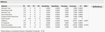

With the XGBoost addin installed and enought data for a 5-folds crossvalidation, I obtain the metrics for XGBoost model :
