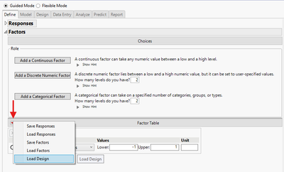

  1. Open your data table containing the results
  2. Launch Easy DOE. If your experiment had more than one response, please add the correct number of responses at this time.
  3. Click the red triangle menu for the Factor Table and select Load Design.
    Load Design in Easy DOELoad Design in Easy DOE
  4. Select your factors and click OK. You do not need to select the response(s), as you will enter these on the Data Entry tab.

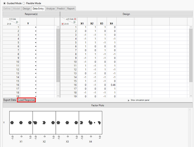

This will import your design and take you to the Design tab. If you've already run your experiment and have the results ready, you can proceed to the Data Entry tab and use the Load Responses button to import the data for the response(s). You can also type in the results manually.
