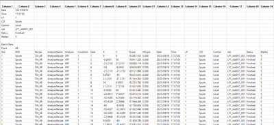

I guess I should have described my dark purpose.  I have a table that can't decide between being a tall table and a wide table.  Columns 1 & 2 rows 1-8 are tall, columns 1-11 become a wide table after row 12.  This script is step 1 in knocking some sense into the table.
before                                                                                 after
I do a series of further steps to process the data but this was the tricky part.
