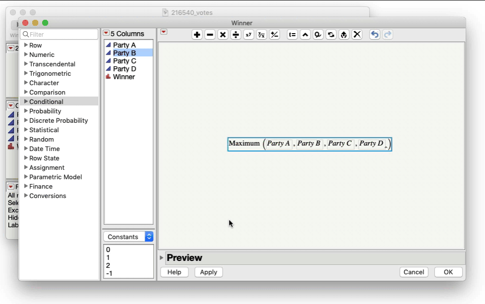

I have a question.
How to do the second part of the formula?
Jeff_Perkinson
Re: I need to compare several columns
The Match() function is under the Conditionals section of the Formula Editor.
With the Maximum() funtion built and selected in the Editor, click on Conditionals -> Match. You'll be prompted about adding arguments, select "Do Not Add".
Then click on the ^ button in the toolbar to add the four pairs of arguments and then fill them in.
-Jeff
