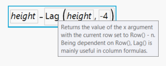

In addition, to calculate with different rows, I recommend the function lag, that returns the value of a row relative to current row, and you do not need a loop.
Georg

Besides using Lag to calculate there is also specific row function for this: Dif ( JSL Syntax Reference > JSL Functions > Row Functions - Dif(col, n) ). Sometimes it might work better than using Lag.
-Jarmo
