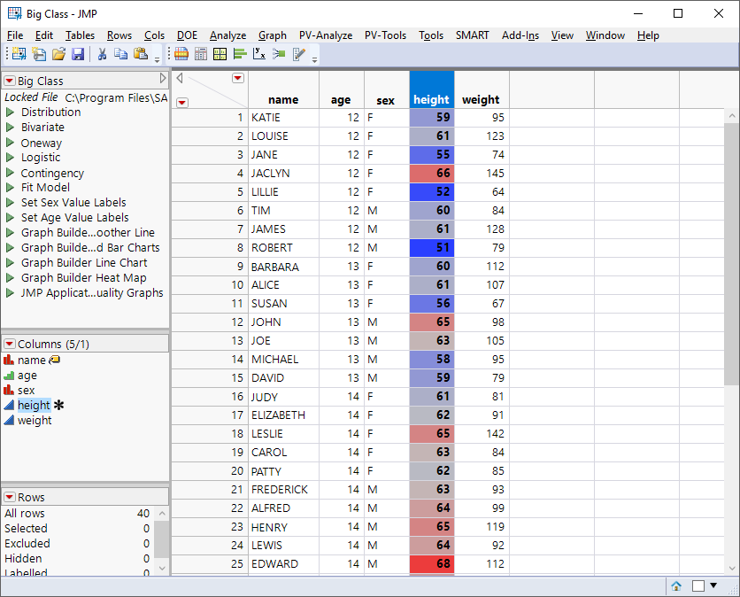

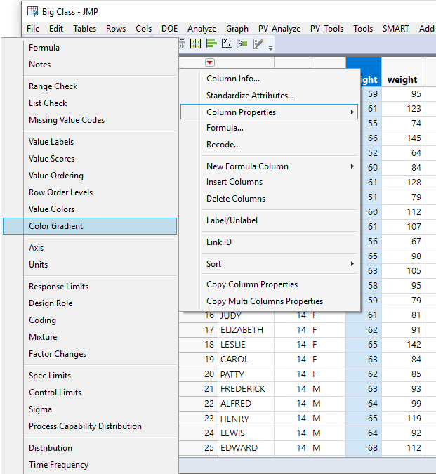

  • Open Big Class
  • Right click on height > Column Properties > Color Gradient

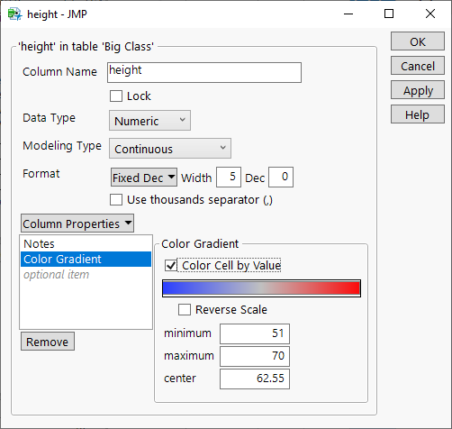

  • Check "Color Cell by Value", then OK
  • You should end up with this:
If this still doesn't work you'll need to contact the JMP helpdesk.

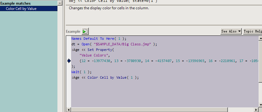

I searched the index and saw only this.
Where I can see a more complete color code?

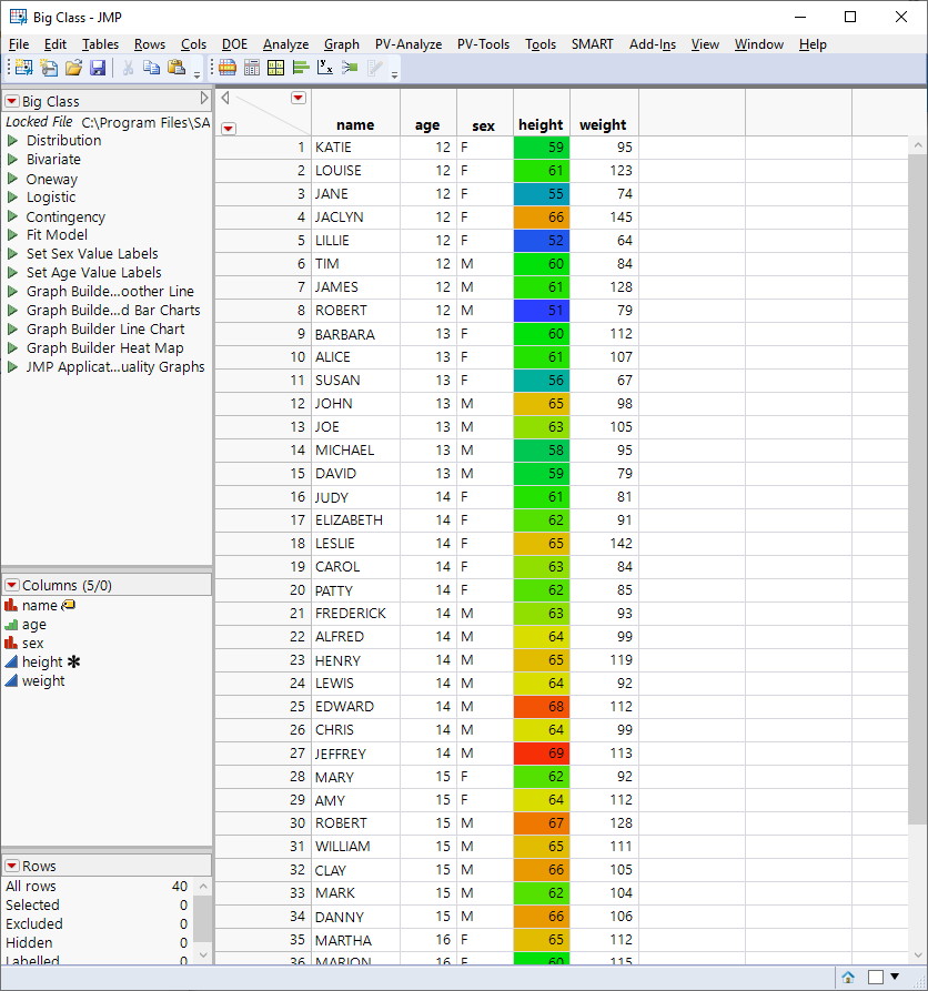

pmroz
Re: How to use JSL to color local cells by value?
You should see this:

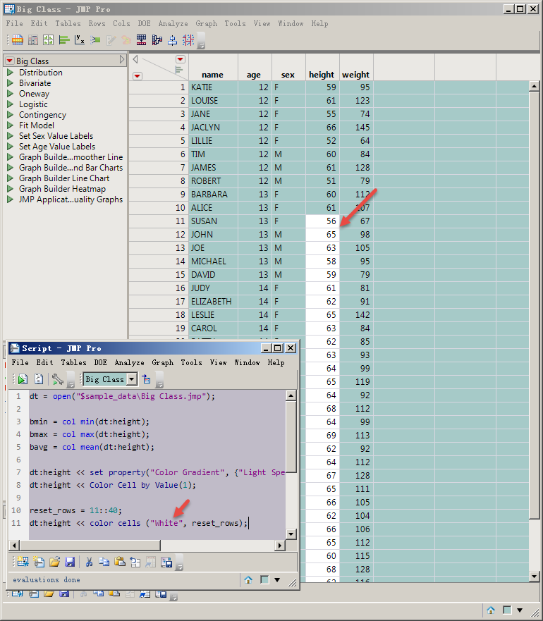

Here's how to only show the color gradient for rows 1-10.  Note that the min, max and mean are calculated on the entire column.  You can adjust that.
dt = open("$sample_data\Big Class.jmp");
bmin = col min(dt:height);
bmax = col max(dt:height);
bavg = col mean(dt:height);
dt:height << set property("Color Gradient", {"Light Spectral", Range( {bmin, bmax, bavg} )});
dt:height << Color Cell by Value(1);
reset_rows = 11::40;
dt:height << color cells ("White", reset_rows);
lwx228
Level VIII
Thank pmroz!
Strange, I still don't see 1-10 lines of color here.Lines 11 to 40 are white.
