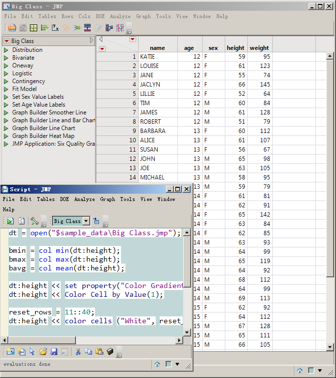

How to use JSL to color local cells by value?
For example, in the "weight" column of "Big class.jMP ", take the data in rows 1-10 and make the gradient color by data height, as in the Image.So can start and stop any color  want.

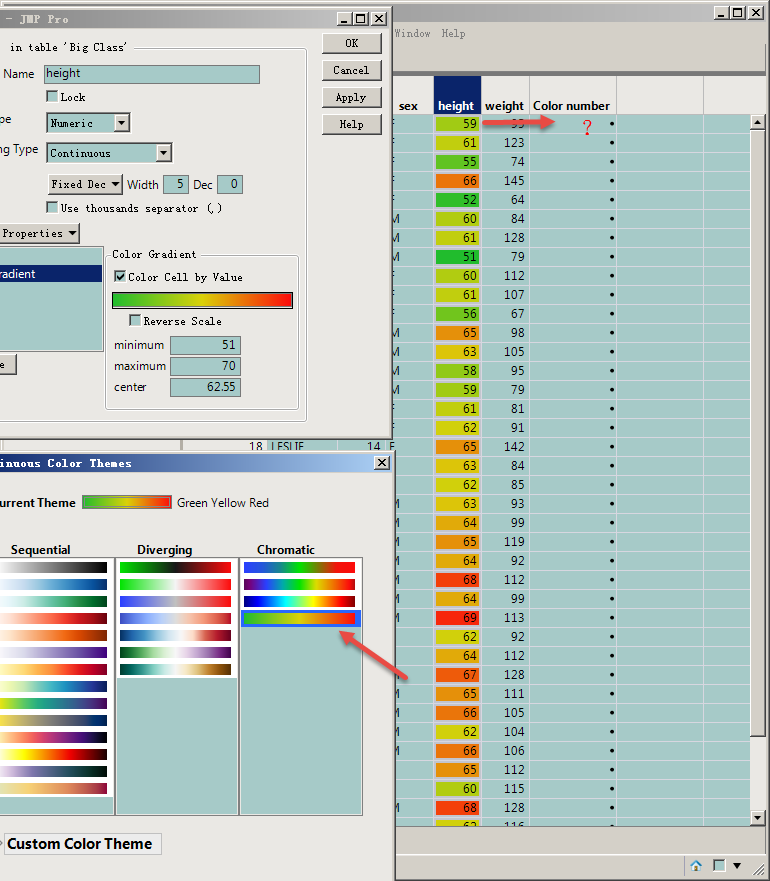

What OS and JMP version(s) are you using?  I'm using JMP 14 on Windows 10, 64-bit.
Try these steps:
  • Open Big Class
  • Right click on height > Column Properties > Color Gradient
  • Check "Color Cell by Value", then OK
  • You should end up with this:
If this still doesn't work you'll need to contact the JMP helpdesk.

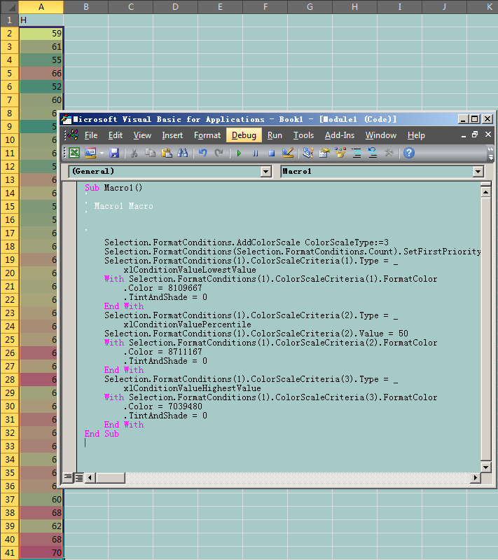

I used to use VBA, and I was able to record most of the code for each step.
Now using JSL, also want to achieve fully automatic operation.
lwx228
Level VIII
Re: How to use JSL to color local cells by value?
  • Recording each step of operation, VBA is relatively easy.

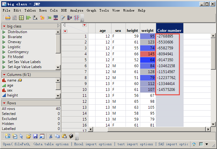

I want to get a color number like this:
txnelson
Did you read the entry that I posted in my previous reply about how to retrieve Cell Colors?  It has a function that can provide you with how to access the cell colors.  If the colors have been set by the use of "Color or Mark by Column" then the only way I know to get the colors, is to create a rowstate column, copy the current rowstates to the new column, and then use the Color Of( Row State( row#)) to retrieve the color value.
