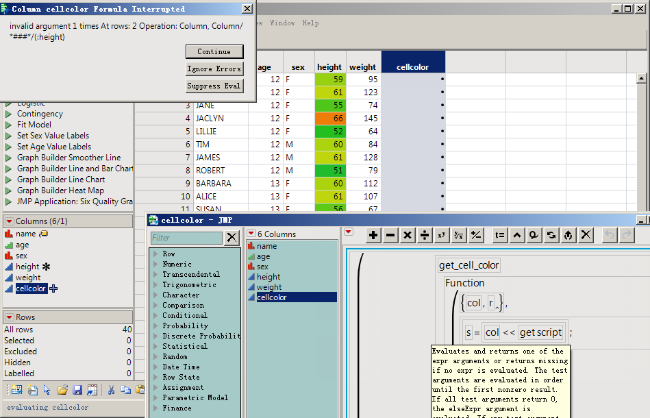

lwx228
Level VIII
Re: How to use JSL to color local cells by value?
Thank Jim!
  • I still don't know how to use this formula. Not running correctly.2020-07-11_07-47.png
txnelson
Attached is a data table with the formula column added, retrieving the cell colors from the Height column.  The colors were set by right clicking on each cell and selecting Cell Color.  The formula will can not retrieve the colors set with Color or Mark by Column, Value Colors or Gradient Color
