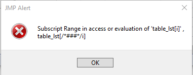

Many thanks for your reply @txnelson . Unfortunately I get the follow JMP alert when I run the script:

I've updated my script as below and it works however after all the tables are open the same JMP Alert comes up again.
Any suggestions?

	Column( table_lst[i], 3 ) << set name( "Property" );

The colors already show you that you have not ended the string tempdir by ";
Reformating the script really helps to see this.

Got it working. Really appreciate all the help!
