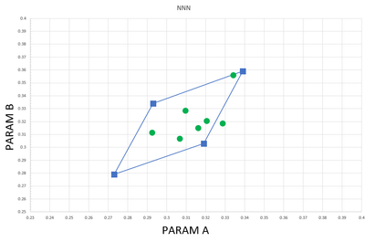

I am looking a way to draw a trapezoid limit inside Fit Y by X chart or graph builder like excel example below. Any idea?

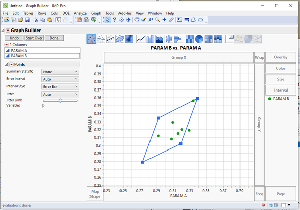

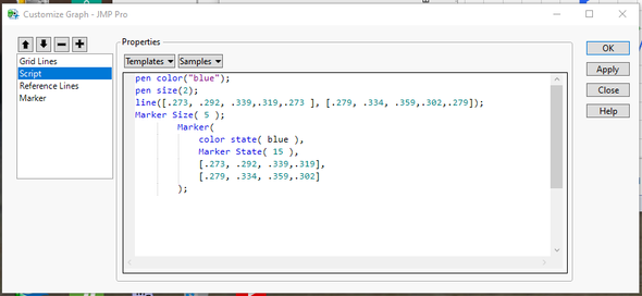

If you right click on the graph, you can Customize the graph, which will allow you to add the graphics you want to the chart.
Here is what the customization window looks like
And here is the simple graphic code required
pen color("blue");
pen size(2);
line([.273, .292, .339,.319,.273 ], [.279, .334, .359,.302,.279]);
Marker Size( 5 );
		Marker(
			color state( blue ),
			Marker State( 15 ),
			[.273, .292, .339,.319],
			[.279, .334, .359,.302]

@OneNorthJMP, Perhaps you will find what you are looking for in the Scripting Index, under the Help menu, by searching Polygon. You should be able to combine what you see under polygon in the scripting index with graph builder by right clicking in the graph space and selecting customize, then clicking the + symbol in the dialog that appears, to add a custom script (polygon()).
