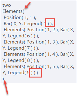

Re: How to make multi-row dashboards with JSL?
I tried to write it yesterday, but it still didn't work.
The problem with this code is the variable "two."
dt << New Column( "col1", Numeric, Continuous, Set Formula( Col Shuffle() ) );
dt << New Column( "col2", Numeric, Continuous, Set Formula( Col Shuffle() ) );
dt << New Column( "col3", Numeric, Continuous, Set Formula( Col Shuffle() ) );
m1 = 1; m2 = 180; m0 = 10;
one=Expr(Variables( X( Transform Column( "Row", Formula( Row() ))) , Y( :height ) ));two=Expr(Elements( Position( 1, 1 ), Bar( X, Y, Legend( 5 ) ) ) );thr=Expr( Dispatch( {}, "height", ScaleBox, {Min( m1 ), Max( m2 ), Inc( m0 ), Minor Ticks( 1 )} ));
first co = 5;last col = 8;
For( i = first co, i <= last col, i++,
  Insert Into( one, Eval Expr( Y( Expr( Column( dt, i ) ) ) ) );
  Insert Into( two, Eval Expr(Elements( Position( 1, Expr(i-3 )), Bar( X, Y, Legend( Expr(1+i )) ) ) ));
  Insert Into( thr, Eval Expr( Dispatch( {}, Column(Expr(i))<<Get Name, ScaleBox, {Min( m1 ), Max( m2 ), Inc( m0 ), Minor Ticks( 1 )} ) ));
gb = Eval Expr( Graph Builder(
	Size( 519, 841 ),
	Show Control Panel( 0 ),
	Show Legend( 0 ),
	Show Title( 0 ),
	Show Footer( 0 ),
	Show X Axis( 0 ),
	Show Y Axis( 0 ),
	Show X Axis Title( 0 ),
	Expr( Name Expr( one )) ,
Expr( Name Expr( two )),
	SendToReport(
Expr( Name Expr( thr ))
gb;

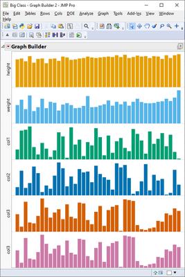

jthi
Scripting Index as examples of both Add Variable and Add Element
Names Default To Here(1);
dt << New Column("col1", Numeric, Continuous, Set Formula(Col Shuffle()));
dt << New Column("col2", Numeric, Continuous, Set Formula(Col Shuffle()));
dt << New Column("col3", Numeric, Continuous, Set Formula(Col Shuffle()));
gb = dt << Graph Builder(
	Size(534, 648),
	Show Control Panel(0),
	Show Legend(0),
	Show Title(0),
	Show Footer(0),
	Show X Axis(0),
	Show Y Axis(0),
	Show X Axis Title(0),
	Variables(
		X(Transform Column("Row", Formula(Row()))),
		Y(:height),
		Y(:weight)
	Elements(Position(1, 1), Bar(X, Y, Legend(10))),
	Elements(Position(1, 2), Bar(X, Y, Legend(9)))
cols = {"col1", "col2", "col3", "col3"};
For Each({colname, idx}, cols,
	gb << Add Variable({Eval(colname), Role("Y")});
	// Either add both of these or neither
	gb << Remove Element(1, 2 + idx, 1);
	gb << Add Element(1, 2 + idx, {Type("Bar"), X, Y, Legend(9-idx)});
Sometimes you have to check the graph builder script to see how it is being built. In this case due to Legend being starting from 10, you either have to first remove element and then add it back OR just let JMP take care of them (so leave out << Remove Element and << Add Element)
Graph Builder(
	Transform Column("Row", Formula(Row())),
	Size(534, 648),
	Show Legend(0),
	Show Title(0),
	Show Footer(0),
	Show X Axis(0),
	Show Y Axis(0),
	Variables(
		X(:Row),
		Y(:height),
		Y(:weight),
		Y(:col1),
		Y(:col2),
		Y(:col3),
		Y(:col3)
	Elements(Position(1, 2), Bar(X, Y, Legend(9))),
	Elements(Position(1, 3), Bar(X, Y, Legend(8))),
	Elements(Position(1, 4), Bar(X, Y, Legend(7))),
	Elements(Position(1, 5), Bar(X, Y, Legend(6))),
	Elements(Position(1, 6), Bar(X, Y, Legend(5)))
-Jarmo

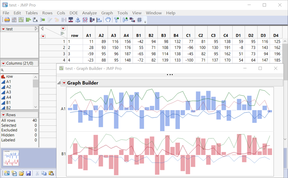

Thanks Experts!
I set more conditions in the actual application.
Like this form.I still don't know how to add multiple columns after the fact
ca = "row";dt = New Table( "test", Add Rows( 40 ), New Column( ca, Character, "Nominal" ) );
Column( ca ) << Formula( Char( Row() ) );dt << run formulas;Column( ca ) << deleteFormula;
na = {"A", "B", "C", "D", "E"};
j = 1;
For( j = 1, j <= N Items( na ), j++,
	i = 1;
	For( i = 1, i <= 4, i++,
		ca = na[j] || Char( i );		New Column( ca );
		Column( ca ) << Formula( If( i == 1, Random Integer( -100, 100 ), Random Integer( 30 * i, 50 * i ) ) );
		dt << run formulas;		Column( ca ) << deleteFormula;		Column( ca ) << Set Display Width( 38 );
p1=dt<<Graph Builder(Size(534,425),Show Control Panel(0),Show Legend(0),Show Title(0),Show Footer(0),Show X Axis(0),Show Y Axis(0),Show X Axis Title(0),Variables(X(:row)
,Y(:A1),Y(:A2,Position(1),Side("Right")),Y(:A3,Position(1),Side("Right")),Y(:A4,Position(1),Side("Right"))
,Y(:B1),Y(:B2,Position(2),Side("Right")),Y(:B3,Position(2),Side("Right")),Y(:B4,Position(2),Side("Right")))
,Elements(Position(1,1),Bar(X,Y(1),Legend(10)),Line(X,Y(2),Y(3),Y(4),Legend(8)))
,Elements(Position(1,2),Bar(X,Y(1),Legend(11)),Line(X,Y(2),Y(3),Y(4),Legend(9)))
,SendToReport(
Dispatch({},"A1",ScaleBox,{Min( -100),Max(110),Inc(50),Minor Ticks(1)}),Dispatch({},"B1",ScaleBox,{Min( -100),Max(110),Inc(50),Minor Ticks(1)}),
Dispatch({},"A2",ScaleBox,{Min(0),Max(210),Inc(50),Minor Ticks(1)}),Dispatch({},"B2",ScaleBox,{Min(0),Max(210),Inc(50),Minor Ticks(1)}),
Dispatch({},"400",ScaleBox,{
Legend Model(10,Properties(0,{Transparency(0.5)},Item ID("A1",1))),Legend Model(8,Properties(0,{Line Color(53),Transparency(0.8)},Item ID("A2",1)),Properties(1,{Line Color(51),Transparency(0.5)},Item ID("A3",1)),Properties(2,{Line Color(52),Transparency(0.8)},Item ID("A4",1))),
Legend Model(11,Properties(0,{Transparency(0.5)},Item ID("B1",1))),Legend Model(9,Properties(0,{Line Color(53),Transparency(0.5)},Item ID("B2",1)),Properties(1,{Line Color(51),Transparency(0.8)},Item ID("B3",1)),Properties(2,{Line Color(52),Transparency(0.5)},Item ID("B4",1)))
}),Dispatch({},"Y r title",TextEditBox,{Hide(1)}),Dispatch({},"Y 1 r title",TextEditBox,{Hide(1)}),Dispatch({},"400",LegendBox,{Legend Position({
10,[6],8,[0,1,2],
11,[7],9,[3,4,5]
Illustration:
A1-A4 is a group of the same letters, are listed as a group of 4, move A2-A4 to the right of the Y axis to form a line graph;A1 is the bar chart,
The color of the bar is variable, but the color of the line on the right is fixed by number (the same color as the line with different letter groups of the number).
The graphics are set to transparency.The right Y-axis title is also hidden.
So there's a lot more code for mapping.I don't know how to batch them.
Thanks!
