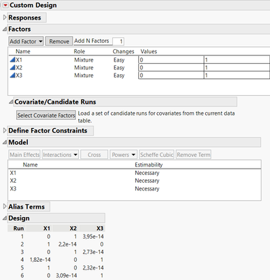

hi,
I have a mixture design with 3 factors and 6 runs initially to perform my experiments, before performing experiments I would like to know whether my design is valid or not? I have used I optimal criterion and have 6 runs without centre points, with 3 mixture factors in 2 levels

Recreating a design in the same conditions as yours, it seems you have assumed only a main effects model :
  • What is your objective with this design and what is your experimental budget/constraint ?
  • What is your system complexity ? Why are you assuming such simple model for a mixture design with few factors (3) ? You won't be able to evaluate mixture of factors with this setup (each experiment only involves 1 factor), so you can really miss a good combination of components as you're not investigating mixtures.
  • I'm also a bit surprised by the use of I-optimality since you assume a model with main effects only. The optimality criterion here won't change anything, you will end up with same/similar designs no matter the optimality criterion with the settings you have.
I would recommend to try other mixture designs models, depending on the complexity assumed and your experimental budget :
  • Using Custom design and specifying 2-factors interactions, you'll end up with mixtures including up to 2 components for a default recommend runs number of 12 (and minimum at 6 runs) :

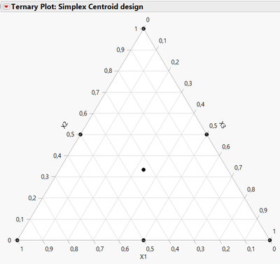

    • Typically, the Simplex Centroïd design is an interesting choice, providing for a minimum of 7 runs (you can add replicate runs) three experiments with 1 component, three mixtures of 2 components, and one centre point with 3 components :

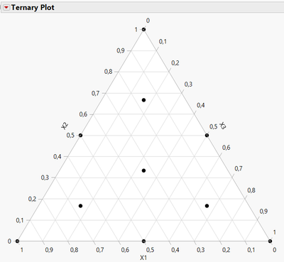

    • An other interesting option is the use of Augmented Simplex Centroïd (available through the "ABCD design" option), which provide the same points as the Simplex Centroïd design and adds 3 points corresponding to mixtures with 3 components. You can use these 3 added points as validation points of the Simplex Centroïd design and associated model (main effects and 2-factors interactions), and/or use them to estimate more precisely model's parameters :
