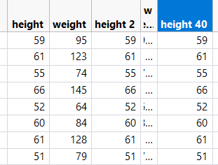

If my data table has 40 columns and I need to make this form of dashboard, how do I script it
Thanks!

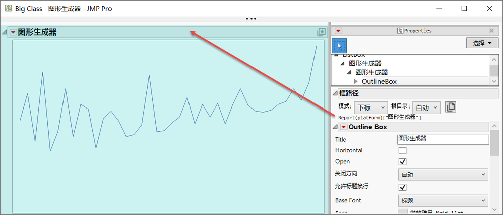

  • Can this name of each window be hidden?
jthi
Re: How to make multi-row dashboards with JSL?
Yes they can. How you might want to do it depends on your application, below is one option using XPath
(nw << XPath("//OutlineBox[text() = 'Graph Builder']")) << Set Title("");

Report(platform)["图形生成器"]
