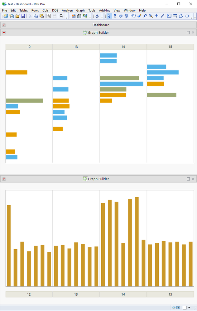

How to implement these two figures in the same diagram?
Thanks Experts!

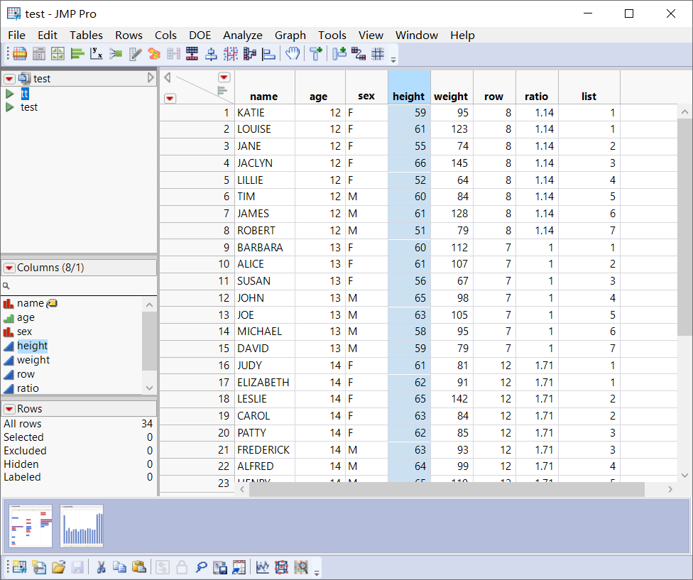

Column( d2, 2 ) << set name( "row" );
mi = Min( d2[0, "row"] );
ca = "ratio";
New Column( ca );
Column( ca ) << Formula( Round( row / mi, 2 ) );
d2 << run formulas;
Column( ca ) << deleteFormula;
dt << Update( With( d2 ), Match Columns( age = age ) );
Close( d2, nosave );

ca = "list";
New Column( ca );
	If( Row() == 1 | age != Lag( age, 1 ),
		r = Row();
		1;
		Floor( (Row() - r) / ratio + 1 )
d0 << run formulas;

jthi
回复: How to implement these two figures in the same diagram?
I would say you cannot (and should not) have them in same graphs as they are displaying different information (at least based on your graph builder scripts). You could combine then into single "report" if needed by using Combine Windows

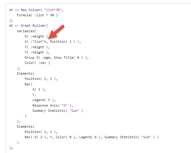

you could rescale "list" by x 30 and use it on the X axis - which will  give this graph:
View more...
dt << New Column( "list*30",
	Formula( :list * 30 )
dt << Graph Builder(
	Variables(
		X( :weight ),
		X( :"list*30"n, Position( 1 ) ),
		Y( :height ),
		Y( :height ),
		Group X( :age, Show Title( 0 ) ),
		Color( :sex )
	Elements(
		Position( 1, 1 ),
		Bar(
			X( 1 ),
			Y,
			Legend( 5 ),
			Response Axis( "X" ),
			Summary Statistic( "Sum" )
	Elements(
		Position( 1, 2 ),
		Bar( X( 2 ), Y, Color( 0 ), Legend( 6 ), Summary Statistic( "Sum" ) )

with the original column ("list") the bottom graph will be squeezed to the left.
with "list*30" the bars will fill the whole graph.
