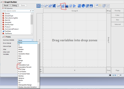

It is infinitely more helpful if an example table to tinker around with is provided. Have you tried the different summary statistic options in the Graph Builder?

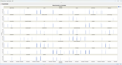

If you want a bunch of mini-graphs combined into one graph, try the Wrap option.
dt = open("$sample_data\Bands Data.jmp");
gb = dt << Graph Builder(
	Size( 1832, 943 ),
	Show Control Panel( 0 ),
	Variables( X( :timestamp ), Y( :viscosity ), Wrap( :customer ) ),
	Elements( Bar( X, Y, Legend( 7 ) ) )
