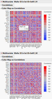

Another option could be to look at correlations with the Multivariate platform.
Specify your variables and the wafer ID in the "By" variable, and you can look at correlations for each wafer, and/or right-click on the Correlations values, "Make Combined Datatable" to export the datatable and process it :
