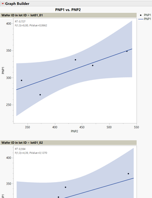

You can also simply use Graph Builder to visualize each pair of X and Y for each wafer using waferID as "Page" :
Graph Builder(
	Size( 534, 99956 ),
	Show Control Panel( 0 ),
	Variables( X( :PNP2 ), Y( :PNP1 ), Page( :Wafer ID in lot ID ) ),
	Elements(
		Points( X, Y, Legend( 29 ) ),
		Line Of Fit( X, Y, Legend( 31 ), R²( 1 ), F Test( 1 ) )
You will have R² coefficient and you can also display a F test to check for statistical significance :
Does it answer your needs or did I understand your topic ?
