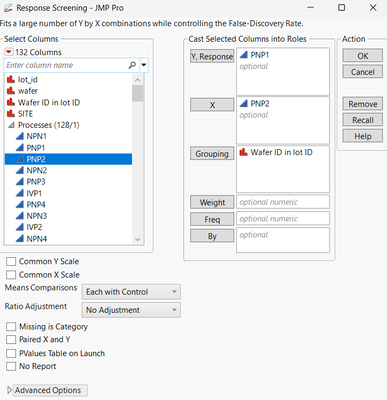

If I understand well your problem, you might be interested by the platform Response Screening (jmp.com).
You want to check if there is significant correlations between PNP1 and PNP2 for all wafers separately :
  1. Launch the Response screening platform, specify "PNP1" as Y and "PNP2" as X, and waferID as your grouping variable :
  2. You have then the results provided by the platform, and you can sort by pvalue, effect size, Rsquare ...
    By right-clicking on the results, and then choosing "Make Combined Data Table", you can then export the results in a JMP datatable and process the results further/differently if needed.

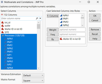

Another option could be to look at correlations with the Multivariate platform.
Specify your variables and the wafer ID in the "By" variable, and you can look at correlations for each wafer, and/or right-click on the Correlations values, "Make Combined Datatable" to export the datatable and process it :
