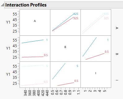

How do I have JMP give a clearer, bigger, simpler two factor interaction plot for just two factors that I hand select for the model that has been fit with Fit Model?
JMP gives a profiler, like so, but it is a giant matrix and frankly not particularly readable if one wants to focus well on one particular two factor interaction.
I see no way to tell it I don't want to see the whole matrix and to select the factors as desired.

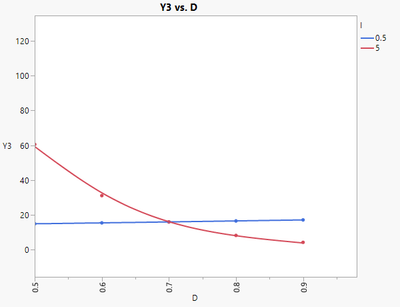

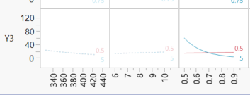

An example below of response Y3 for the two factor D x I interaction -- I had transformed Y3 with a log (time to failure):
Using local data filter:

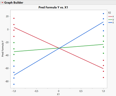

It should be possible to do it with Graph Builder, provided that you saved and used the Prediction formula of your response from your model.

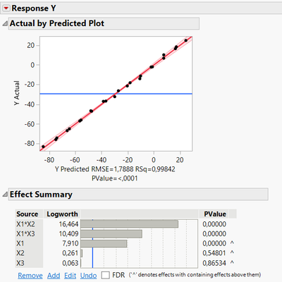

As an example, I used the dataset "2x3x4 Factorial" available in the JMP sample index.
When building the model, it seems that two interactions effects are significant :

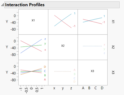

The interactions can be seen in the "Interaction Profiles" panel :

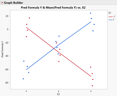

I save the Prediction formula for the response Y, and use it in the Graph Builder, use X1 as X and X2 as "overlay" role variable in the Graph Builder and I am able to find the same interaction plot than seen before :
I can also do it with X2 as X and X1 as overlay variable, even if X2 is a categorical factor, as this factor has a "Value Order" property, so JMP knows in which order to display the levels. I end up with this graph, very similar to what was shown previously in "Interaction Profiles" panel :
And here with X3 as X variable (and removing points from Graph Builder to make the visualization more simple) :
Of course you can customize the graph, removing the points or keeping them, changing the colors, visualisation styles, ... Take also care that the Y range of the graph is the same than the predicted Y values range, in order to have the same slope and behaviour for your interaction (and not have misleading visualization).

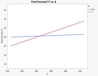

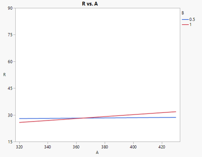

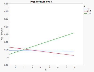

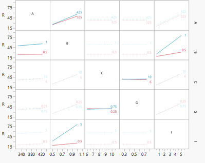

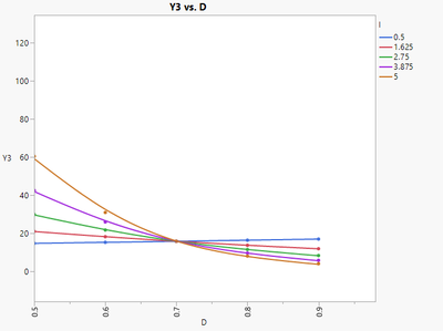

Attached is an experiment, including because it has the additional element of a 3rd level for each factor.  Check out the CG interaction in the "Fit Least Squares" interaction profiler.  How to pop that out separately without the entire matrix of all the factors is my goal.  There must be a command somewhere to do this.  Saving the Y predicted formula then using graph builder does not recreate what is shown in the profiler.
Profiler:
Graph builder of Y predicted formula:
Victor_G
Re: Creating two factor interaction plot (without the full matrix profile)
Hi @CanonicalHazard,
Thanks for the example dataset and sorry for my delay.
I found the same results as you, and using the magnifier tool, I can see on the interaction plot you show that intersection between lines is at C = 2, which does correspond to the intersection for levels G at 82,5 and 120 (not 45 and 120).
I don't understand why we are not able to reproduce the same graph as in "Interaction plots". I thought this may be due to a problem of coding the levels for the factors, but I checked and this was not a problem.
I am clueless, but this may be due to the presence of a third (intermediate) level ? For designs involving 2-levels continuous factors, I am able to reproduce the Interaction plots without any problem.
