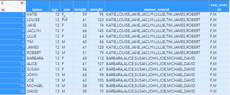

Subscripting data tables is very handy but is it possible to use the "by" function in this (for example by( :age )) to pull all the names of people who have the same age into the column?
Here is an example:
I'd like to take all the names where the age is the same and concatenate them in a column.
One of the common next steps is then summarizing other columns by those concatenated names.
I've dug through and tried multiple approaches and I think I'm just missing something simple, but what I'm hoping is that there is a very straightforward way to do this using either subscription or something like
dt:name << get values(by(age)) and then either put that in a column or use it in a script.

Apparently, all I needed to do was post and I instantly found an answer.
fr = Col Minimum( Row(), :age );
lr = Col Maximum( Row(), :age );
dt:name[Index( fr, lr )];
//returns {"KATIE", "LOUISE", "JANE", "JACLYN", "LILLIE", "TIM", "JAMES", "ROBERT"}
This is exactly what I was looking for.
Using the col min and max with row is pretty simple, so that works.
However, I am curious if it's possible to use a by(age) argument in the subscript directly, I've used it in Make Validation Column and it makes it so much easier to do.
Thank you,
Aron
