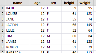

You've always been able to subscript columns in a data table as one dimensional vectors.  In JMP 13 you can subscript a data table as a two dimensional array.  Here are some examples using big class.   (The very last example shows the column subscripting.)
dt = Open("$SAMPLE_DATA\Big class.jmp");

The data table subscripting makes it easier to work with a table than before; you can swap rows or columns with a single (slightly complicated) statement, or copy blocks from one table to another, or extract a matrix from a subset of the table using a matrix of rows and a list of columns that identify the subset.
