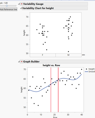

Hi,
How can I add label to the reference lines?
Here's my code:
Any advice?

			gb = dt << Variability Chart( Y( :height ), X( :sex ), Show Range Bars( 0 ), Std Dev Chart( 0 ), Points Jittered( 1 ) );
			gb = dt << Graph Builder(
				Size( 373, 325 ),
				Show Control Panel( 0 ),
				Variables( X( Transform Column( "Row", Formula( Row() ) ) ), Y( :height ) )

See the new code for how the change is handled.

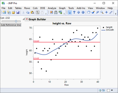

jthi
Re: How to add label to red reference line?
I'm not sure if you can move graphics script outside Frame Box, but if you are ok having the label inside FrameBox
You can add Text to your graphic script
Text Color("Red");
Text({0, LL}, "Lower");
Text({0, UL}, "Upper");
-Jarmo

			Button Box( "Add Reference line",
				If( Flag == 0,
					Flag = 1;
					gbfb1 = Report( gb[1] )[AxisBox( 1 )];
					gbfb2 = Report( gb[2] )[AxisBox( 1 )];
					LL = Mean - (sliderValue * 3 * std);
					UL = Mean + (sliderValue * 3 * std);
					wLL = wMean - (sliderValue * 3 * wstd);
					wUL = wMean + (sliderValue * 3 * wstd);
					try(gbfb1 << remove ref line(holdLL));
					try(gbfb1 << remove ref line(holdUL));
					try(gbfb2 << remove ref line(wholdLL));
					try(gbfb2 << remove ref line(wholdUL));
					gbfb1 << add ref line( LL, Solid, red, "LL" );
					gbfb1 << add ref line( UL, Solid, red, "UL" );
					gbfb2 << add ref line( wLL, Solid, red, "LL" );
					gbfb2 << add ref line( wUL, Solid, red, "UL" );
					dothisonchange( sliderValue );
Jim
