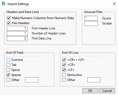

I'm currently trying to stack a range of individual .txt files into a single JMP data table, but I'm having issues with the final import structure. Maybe someone can poiint me in the right direction, p[lease?
Let me describe the steps I took:
1. All individual .txt files are in the same directory
2. All individual .txt files have the same size and layout (2 lines, Line1 - headers; Line2 - data) and delimited by spaces
3. File -> Multiple File Import
4. Keep  'Data, Using CSV settings' and 'Stack Similar Files' options selected
5. Under the 'CSV Settings' options, have the following options selected:
6. When I then Import the files into one data table, the ouput in terms of staking the 45 files in individual rows is correct, but it doesn't split the data/headers in to different columns (see below). Any clues? Thanks, Vasco

Re: How do I stack text files into a single Data Table, using MFI
Check your preferences?
I had a similar problem, and the  "CSV Standard" button wasn't checked by default, and sometimes would uncheck automatically.
