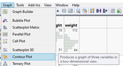

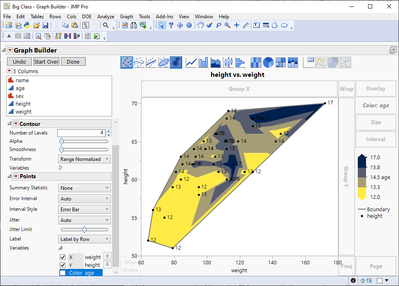

Depending on your plot, you might want to use Contour instead of Graph Builder
Or if you have JMP18 it should be fairly easy to use labels for your markers (set your Z column as Label column and label all rows in your table)
-Jarmo

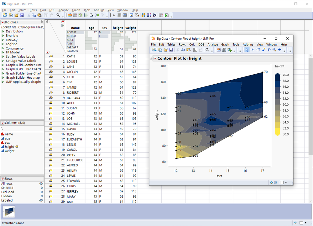

jthi
Re: How to label the data points in scatter plot on Graph Builder?
You might be able to do what you want using Label column and by labeling all rows (don't enable Label Contours)
