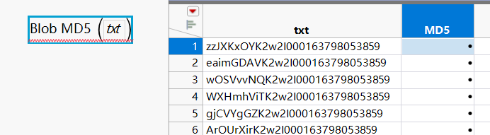

Can JMP compute the MD5 value for each row of text in the specified column?
txt
zzJXKxOYK2w2I000163798053859
eaimGDAVK2w2I000163798053859
wOSVvvNQK2w2I000163798053859
WXHmhViTK2w2I000163798053859
Thanks!
