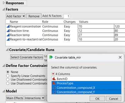

Case 1 (Adding both covariates and ProcessType as “easy to change” covariates):
Factors and responses are already in the dialogue window. Then, I press the “Select Covariate Factors” button and add the covariates as shown below. The covariate table has 900 rows, and each row represents an individual batch.

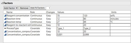

I leave all factors at the default setting “Changes = Easy”:

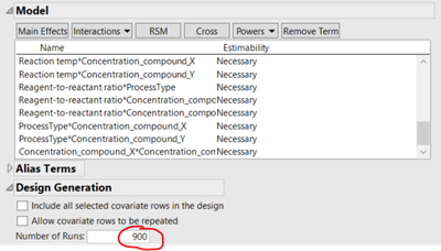

After adding the interactions, the design ends up with 900 runs.
Clearly, this is a bogus design. No one will perform 900 runs, at least not voluntarily.
Case 2 (Adding both covariates and ProcessType as “hard to change” covariates)
In this example, the covariates and ProcessType were all added with role “Covariate” again, but factor change was set to hard. This creates a whole plot design with default 45 runs:

  • I am a little bit surprised with the 900 runs generated in case #1. Am I misled in believing the design generating algorithm should pick a suitable number of batches and runs? Or is it my responsibility as user to tell JMP the number of runs I find suitable, evaluate the design and decide whether I need to improve on it by adding more batches from the covariate table?
