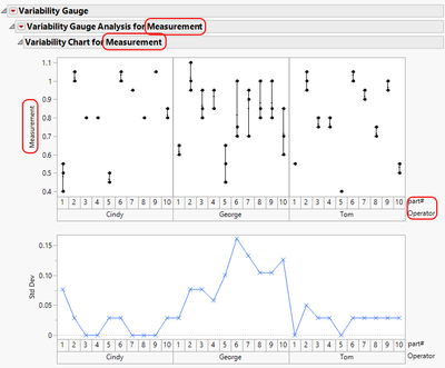

In the variability report, there are a number of cases where column names are used in titles or labels.  When the name is used by itself, customizations may be working fine.  The more common problem case is when the name is embedded in another string, as in the Outline titles here:
Unfortunately the only solution for JMP 17 and earlier is to use a JSL switcher callback script to reapply the customizations.
