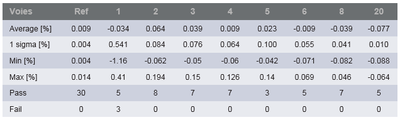

In fact I have a small issue because I want to do a PDF file with JMP that can be a summarized of some graphs (save in datas table JMP) and a table from some greatness of Analysis (average, sigma, min and max).
ex :
So I want do for each graph his tableau and put that on a PDF file.
I put in attachement my JMP file.
NB : the present table does not correspond to the graph above.
