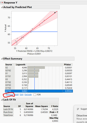

ZHANDOUJI
Level III
Re: HOW to fit two model with different terms at the same time
OH,Thank you very much! Idont find the "remove" button before.I know these basic knowledge about fitting model and model selecting.I used to use Design expert,I am just not familiar with this software.
ZHANDOUJI
Level III
I have tried to click the option “fit separately” and I get two model with same terms.I cant refine my model directly in the report,so I use the stepwise method and this allow me to re-select the terms I want for each model.
