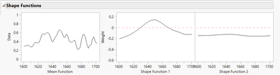

Direct PCA shape function:

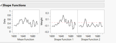

P Spline shape function:
I'd like to check if my interpretation is correct. I believe shape functions are the loading plots for my PCA analysis, right? Is it ok to say that shape function 1 and 2 explain the wavenumbers that had the highest contribution on my PCA grouping?
And just for my curiosity.... is there any reason that shape functions for P spline look kinda "dented" whereas for B spline and direct PCA they look smooth?

    Visually, diagnostics plots are also super helpful. On your attached file, it seems P-Splines does a better job than Direct PCA, which might smoothen and simplify too much the signal from spectral data (as with B-Splines, which are polynomial splines models). Since the signal seems (over-)simplified with Direct PCA, it may explain why you are able to explain 99% of the variation with 2 Functional PCs with this model. Depending on the type of model you are fitting (B-, P-Splines, Direct models, Wavelets, ...), the complexity (and predictive performances) will be different and will lead to different complexities/ of Shape Functions.

  2. Shape Functions are Functional Principal Components, so they help understand visually which area of your spectral data are the most important to discriminate and explain the differences between your samples. But several Shape Functions can be linked to the same spectral area, so the influences/importances are not so direct to assess.

In the shape functions, the graph from the left says mean function... may I understand why the Y axis for this graph is "data" whereas for the other two is "weight"?
And one more question, is there a way to export these graphs to excel? This is so that I can put them in the same format as the rest of my material.
