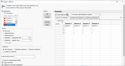

I tried creating a Flag column, assign 1 to each header then subset. But the result is incorrect as it subset 1 and blank with Subset 1 with all the headers. This is what I created:
CSV << New Column ("Flag", Numeric);
r = CSV << getRowsWhere( Contains( :Header 1, "Header " ));
Column(CSV, "Flag")[r] = 1;

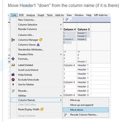

Move Header1 "down" from the column name (if it is there),

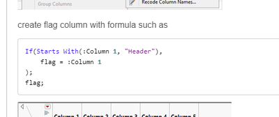

create flag column with formula such as
If(Starts With(:Column 1, "Header"),
	flag = :Column 1
flag;
Then you can subset using that new column as By
-Jarmo

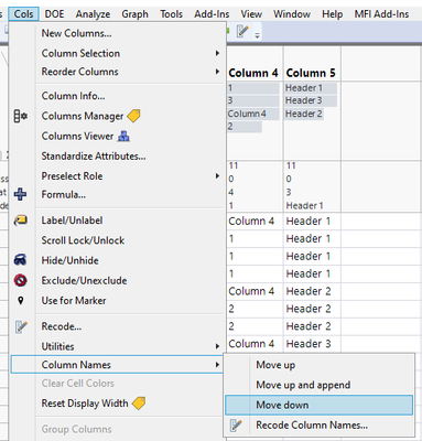

Sorry, Im a little bit confused. How did you create Header1 Column?
jthi
Re: How to subset data with some headers in rows?
Using Column Names -> Move down
	flag = :Column 1
flag;
cool , temporary flag - available also for subsequent rows.

You might want to make it a bit more robust by making sure it has been initialized for example by using As Constant() (or If(Row() == 1,....). In this case is wasn't necessary so I didn't bother with it
As Constant(flag = "");
	flag = :Column 1
flag;
Also the readability might improve with something like
If(Starts With(:Header 1, "Header"),
	flag = :Header 1
	flag
You just want to "return" the value you wish to see in rows.
-Jarmo
