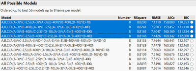

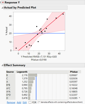

The "Stepwise" selection approach is different, more oriented like a "model-agnostic" analysis, where the selection of the terms do not necessarily follow some of the DoE principles (even if you can "lock" some terms like main effects to respect effect heredity/hierarchy), but is focussed on optimizing a criterion (AICc, BIC, ...). This can result in more complex models, as the "safeguards" from other platforms like "Fit DSD" may not be present. If you want to really push the boundaries and explore other designs with the Stepwise platform, you can also click on the red triangle, and try "All Possible Models". You can specify the number of terms in the model, and JMP will try all possible combinations of terms to provide all possible models with the number of terms specified. It can give you some "inspiration" in the modeling, but the results should be taken with caution, as some terms may be entered in the model without any statistical significance (so a little bit of fine-tuning might be needed after) :
With the first model (some terms are added by default but their p-values are above the 0,05 threshold):
