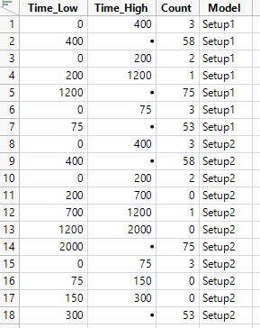

I have a reliability dataset where some of the readouts did not have any fails. Do I merge these readouts with the ones that have fails or include them separately?
Please refer to Setup1 Vs Setup2 in the snippet below [JMP file attached too]. Weibull alpha and beta parameters between Setup1 and Setup2 are drastically different. To me, setup2 seems reasonable since it includes complete information.

This issue has been resolved. Setup1 Time_low entries need to be corrected. For e.g. Row4 Time_low entry should be 700, not 200.
