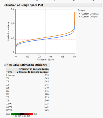

What is your objective with this design ? If your objective is about exploring and understanding the links between your factors and your response(s), I'm not sure prediction variance is the most interesting indicator for your design (since you also seems interested in D-efficiency). Moreover, the change you see in the Fraction Design Space plot looks very marginal, so I doubt this slight improvement will create a meaningful practical impact in your experiments and system understanding.

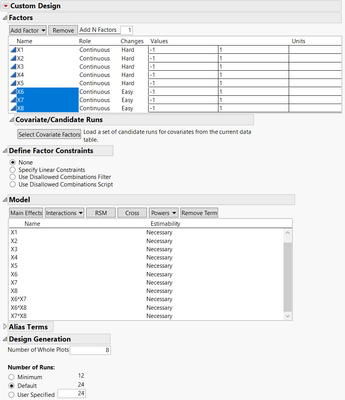

I might have misunderstood something, because trying to reproduce the design you intended with only main effects for 5 hard-to-change factors and main effects + 2-factors interactions for 3 easy-to-change factors leads me to a recommended design with 24 runs and 8 whole plots :
On a side note, in a split-plot design you can estimate 2-factors interactions between easy-to-change factors, as they are fully randomized compared to hard-to-change factors which have a restriction on their randomization.

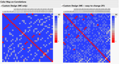

Depending on your need and precision estimation of main effects + 2-factors interactions for easy-to-change factors, specifying a design with only main effects when creating your split-plot design with your 8 factors could help allocating the aliases on the interactions involving hard-to-change factors :
You can see in the main effects split-plot design that main effects are completely uncorrelated/non-aliased, and so are the 2-factors interactions for easy-to-change factors (from X6 to X8).
I attached the two designs generated so that you can have a look and compare the two design options,

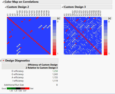

However, when I increased the number of runs to 32, so one additional easy-to-change factor combination per whole plot, I noticed an improvement in the prediction variance, a reduction in the average correlation and a better D-efficiency. Since doing an extra experiment per whole plot is feasible, and for most substrates there is more than enough material to execute all experiments, I opted to go for the design with 32 runs.
Unfortunately, for 1 substrate I lack sufficient material to do all 32 runs. So, the idea was to select for this 1 substrate only 24 runs out of the 32 in the design (remember, in this experiment every run corresponds to an adhesive formulation). Then the question still is, how to best select which runs to drop, and which to retain for that one substrate.
As an alternative I could go for the recommended design of 24 runs for all substrates, but it seems to be a pity that I lose the improvements associated with the 8 extra runs. Unless of course, and that is for me difficult to assess, that the benefits in terms of effect estimation and significance testing when going to 32 runs would only be marginally better than that of the 24-run design.
Custom design 2 = 32 runs
Custom design 3= 24 runs
