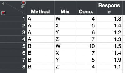

 I was also made aware of the JMP Profiler feature. This would be fantastic if I could use it to optimize a variable that's is broken about 100 times. Here’s an example of the data table I put together to show how the variables are broken up.
 Briefly, I have a Response variable for a given concentration. So, fitting the X by Y would produce an equation that I could use, but since I have this equation measured about a 100 times for each Mix and Method. I want to find a way to populate those specific equations in the JMP data table so that I can calculate the Optimal Conc. for a Response equal to 1.

You said you want to know what Conc. will give you a prediction of 1. Do you want to know that for each combination of Method and Mix? The reason I ask is because in your sample data set you only have one Conc. and Response for each unique combination of Method and Mix. I realize that this is a mock data table but, in your real data table do you have multiple Conc. and Response values for each combination of Method and Mix?

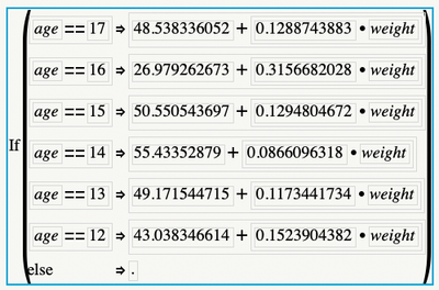

1) The Ctrl (Window) or Cmd (Mac) key will broadcast commands. For example if you open the Big Class data table (from Help->Sample Data Library) and run Fit Y by X with Height and Weight in Y and X, respectively, and Age in the By role. You'll get one Height by Weight platform for each Age. If you hold down the Ctrl/Cmd key as you choose Fit Line and also Save Predicteds you'll get a prediction formula that takes Age into account:

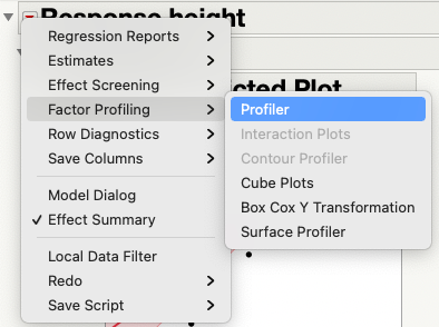

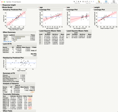

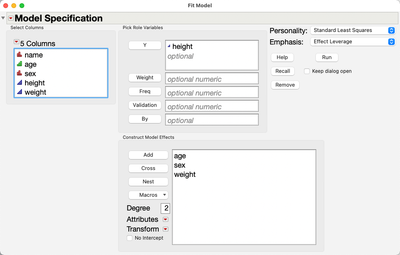

2) Fit Model will allow you to build a prediction equation that considers Method and Mix and give you a single prediction profiler. Again, use Big Class choose Fit Model and put Height in the Y role and add Sex, Age, and Weight as effects.
You'll get a Least Squares report.
You can use the red triangle menu at the top to add a Profiler.

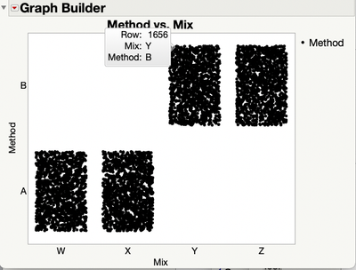

The first thing I notice is that your Method and Mix columns are confounded. That is, Method A only has Mix X and Y, and Method B has only Mix Y and Z. So, if your real data looks like this there is no point in including both Mix and Method.

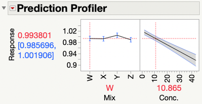

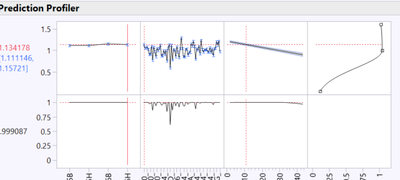

After running Fit Model with only Mix and Conc. in the model you'll see a profiler like this.

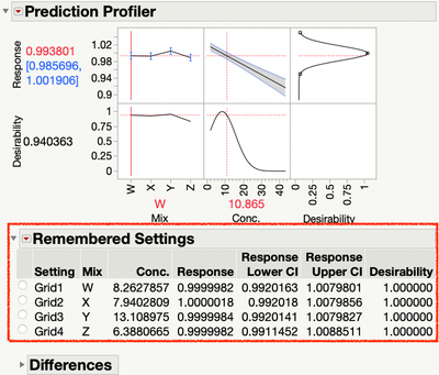

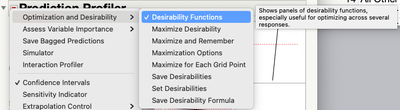

From the red triangle next to Prediction Profiler you can choose Desirability Functions.
That will add a panel on the right side of the Profiler. You can double click on that panel and set the desirability values to match your target of 1.
Once you've done that you can use the option to Maximize Desirability to find a Mix and Conc. that will get get you to your desired response.
Next, if you Ctrl-click in the Mix graph you'll get a dialog where you can lock Mix.
Once the factor is locked the Maximize Desirability option will not change Mix. So, you'll get a Conc. for whatever level of Mix you've chosen. You can change Mix and do that again for another Mix level.
Finally, once the factor is locked you can choose Maximize for Each Grid Point.
This will automatically maximize for each level of Mix.

 You're indeed right about the mixes being redundant. I got the same graph with my data too. I followed your instructions to set the Desirability, lock it for each grid point...etc. And it worked at the Mix & Conc. level but when I repeated it with the Icon varible I couldn't get them to show up in the table at the bottom. I'm not sure how to get that output (and put it in a new data table) so I can apply that in my next experiment. The Remembered Settings should list all the Icons but it's only including a few of them.
 As you can see below my prediction proflier came out slightly different than yours for some reason. I don't have a nice bell curve. Would be good to know what you think I may have done different just to be sure; but since it's ultimately due to the data, I'm not sure what the difference is.

 I re-tried using the profiler to set the Desirablity settings to 1, lock them for the mix and apply the Maximize for Each Grid Point. I discovered that it did repeat as I'd shown before but if I clicked the red arrow again to Max. for Each Grid Point, it woud add more Icons to the Remembered Settings list. So I re-read your instrucitons and realized you may want me to lock each Icon variable, which doesn't seem feasible since there's like 100 of them in one tiny graph that I'd have to click on each time. So I think that won't be very feasible. I you're able to provide a little more instruction then I'll try and repeat the analysis for Mix, Conc. and Icon again.
 I also noticed after my analysis that although I had locked the Maximum Desirability setting for Mix, I can click on each mix and the Response number in read to the left will change. I guess that if I click on anything in the upper portion of the profiler the numbers will change but the output that's in the lower portion of the graph is set to 1 and that's what is reported in the Remembered Settings table at the bottom.
 So by using the profiler and following your analysis and setting just the Mix at 1, does that lock all the other variable outputs for that mix? If so, why would I have to lock Conc. or Icon. And if I do indeed have to lock the Desirablity and Maximize for Each Grid for the other variables how do I do that? Icon like you said is too high a number and Conc. will change.
