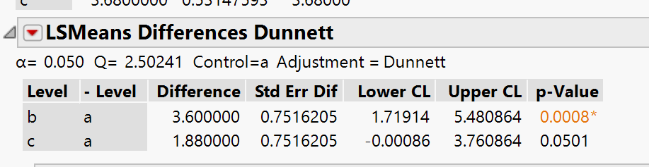

I've put together some fake data to illustrate what is going on:
I've chosen the data such thast the contrast between c and the control (a) has a p-value of 0.05 i.e. the threshold at which we are assessing statistical significance.
A t-statistic can be calculated as a the ratio of the difference to the standard error of the difference.  For the second contrast the statistic is 2.5 i.e. the Q statistic.  So whilst there is a statistic for each comparison, we can define a single statistic to that is the threshold for statistical significance.

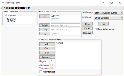

Here is a simple example with dummy data (Y) for 3 categorical levels (X)
Go to Analysis > Fit Model and assign your Y and X as shown:

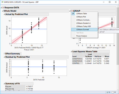

Click Run, and in the model result, go to GROUP effect > Dunnett's

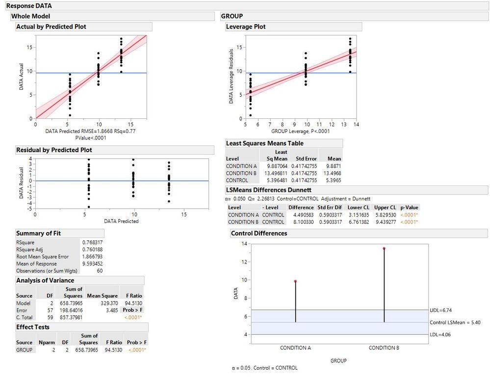

The resulting screen in giving you the full test statistics (LS Means Differences Dunnett's) as shown in this final screenshot:
That should satisfy the reviewer. If it does not, you should try to clarify what he/she means by Test Statistics.

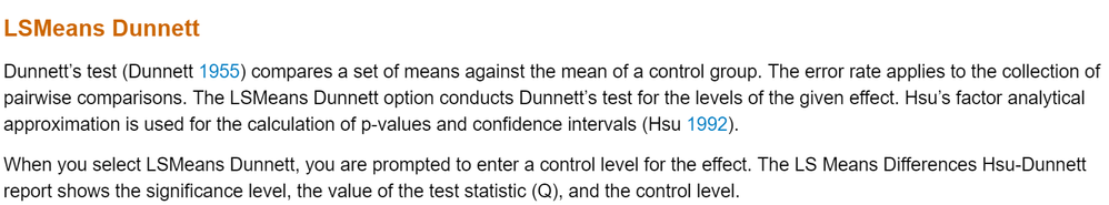

Also I should have mentioned JMP's online help:
https://www.jmp.com/support/help/14-2/effect-details.shtml#625536
