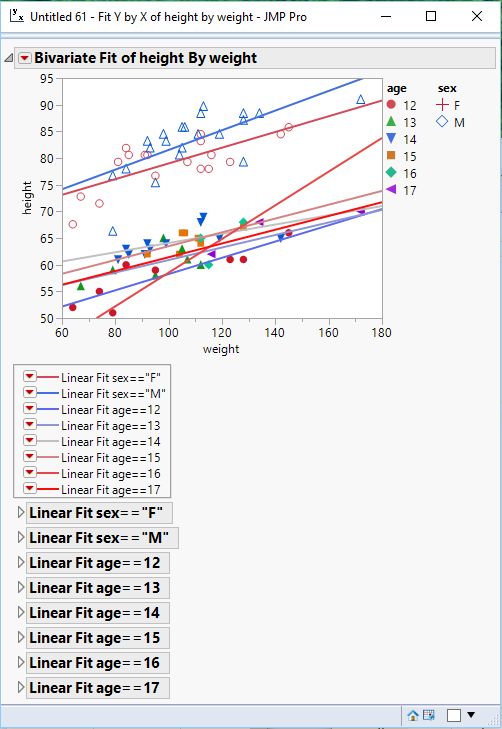

Well, I think it can be done.
The data table had to be modified...see the attached table.  I then had to group first by Age, and create the linear regressions, then on Group, and then Group again with the Sex column, and then generate those regression lines.
Finally in the data table, there is a new column called Column 5, which is a composite of the Age and Sex values.  It is used to generate the row states for the rows, matching to the legend colors and markers set for the 2 groupings.
Not very pretty in getting it done, but.......it was possible
Jim

hi txnelson,
your example indeed only grouping by the later one which is 'age'. I couldn't see and point that are show the 1st grouping sex F '+' & M 'diamond'.
I want 1st grouping different by color.
2nd grouping different by marker.
But the row legend only accept 1. If i choose the 2nd one, the 2nd one will replace the first one.
txnelson
Re: Fit Y by X Legend with Color & Marker
You are correct........and I should have more clearly stated what I was attempting to show.  Here is a further modification of the output
What I intended to illustrate, was that using the features of JMP data tables and the Bivariate Platform, that you can probably get the display to the point that you want it.  Getting the graph to the point that I displayed, took several steps to get the legends you desired, and the linear regressions you wanted.  It also then took a lot of manual work changing the colors and markers to the point that I displayed.  I was hoping to illustrate that your precise goal was probably possible.  And I think it is......but it will take your knowledge of exactly what you want, and the mapping of it to data table changes and Bivariate Platform features to make the final product.
Jim
After multiple try, i think i got what i want.
It need to carried out by 2 step.
the first step is chose *MARKER* but set without colour.
then 2nd step by set no marker but chose *COLOUR*
And the final outcome that i want.
