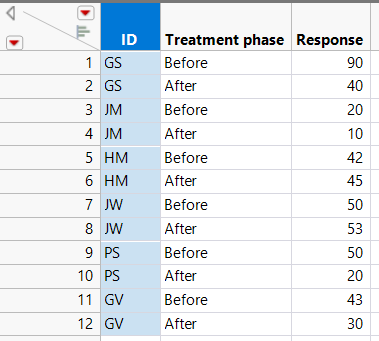

This graph is quite easy if you have a datatable containing the columns ID (GS, JM, HM, JW, ...), treatment phase and the response in stacked format :
Using the graph builder, you can then set "treatment phase" as X, response as Y axis, and ID as "overlay" variable.

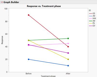

You can then Shift + Left click on "Line" to add connecting lines betwwen the data points.
You can then hide the points marker in the legend, change the colors, set "Value Order" column properties to order your ID and the treatment phase (because else it will be ordered by default in alphabetic order), and specify the jitter of the points as "None" so that the line do connect the points exactly.
At then end, you can obtain this graph :
And here is the script for this graph :

First, your data should be arranged in a stacked (i.e., tall) format, with a column for time points (Before and After), a column for individual identifiers, and a column for the values you want to plot.
Go to Graph Builder, assign the Y axis to your data values, the X axis to the time points, and the Overlay to individual identifiers.
Choose Points and Lines (Upper menu) to show each data point connected across the time points.
Of note, to align the Dots with the Line, go to the Points customization menu (lower left) and select Jitter > None.
From here, you can experiment with different formatting options.
