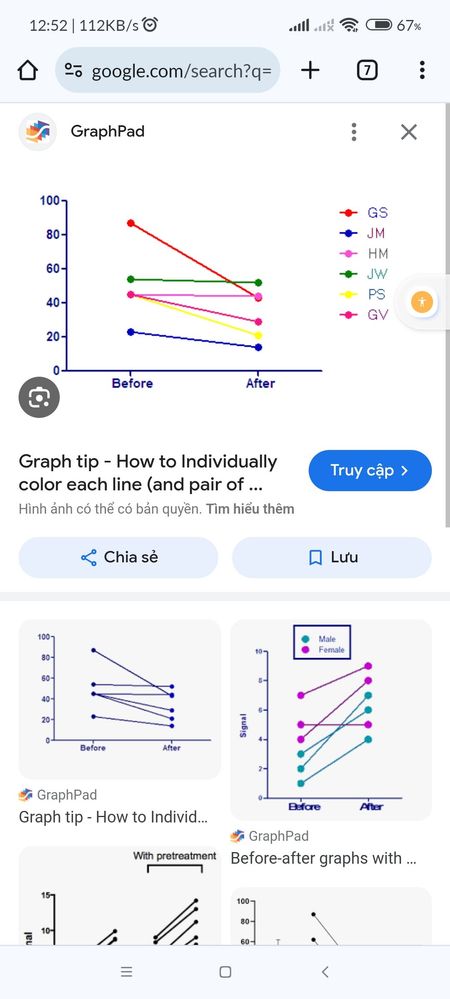

How I draw paired data like that in JMP? Hope the help from our community.

This graph is quite easy if you have a datatable containing the columns ID (GS, JM, HM, JW, ...), treatment phase and the response in stacked format :
Using the graph builder, you can then set "treatment phase" as X, response as Y axis, and ID as "overlay" variable.
You can then Shift + Left click on "Line" to add connecting lines betwwen the data points.
You can then hide the points marker in the legend, change the colors, set "Value Order" column properties to order your ID and the treatment phase (because else it will be ordered by default in alphabetic order), and specify the jitter of the points as "None" so that the line do connect the points exactly.
