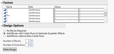

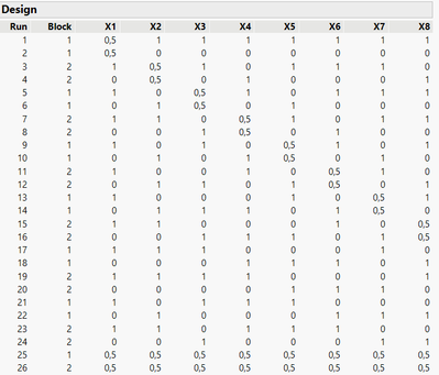

Hello,

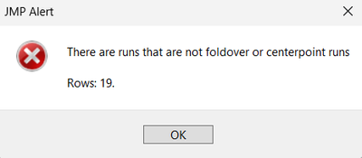

I ran a Definitive screening design and generated a table by selecting "Add block with center runs to estimate quadratic effects. I collected the response data and added it to the table. But when I try to run "Fit Definitive Screening", I'm met with this error:
The Fit Definitive Screening platform only runs when I hide/exclude runs from block 2. Am I doing something wrong? How do I run a model with all of the runs included? Do I have do some kind of augmented design to include the second block?

Sorting the datatable don't change the design structure and analysis. However, removing an experiment from the table will destroy the design foldover structure (there will be one experimental run without its "mirror image" counterpart, which prevent from using the Fit DSD analysis platform). You will face the same problem and error message with response missing value(s), or by excluding row(s) in the table.
I have the same error message than you when removing any run from the design table and trying to launch the Fit DSD platform :
I would recommend using other modeling platforms (as mentioned in my response before) to do the analysis.

Hi @sanch1,

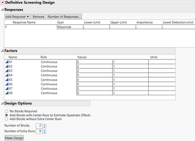

I just tried to reproduce the same error by creating the same design type with 8 continuous factors, 2 blocks, 8 extra runs :

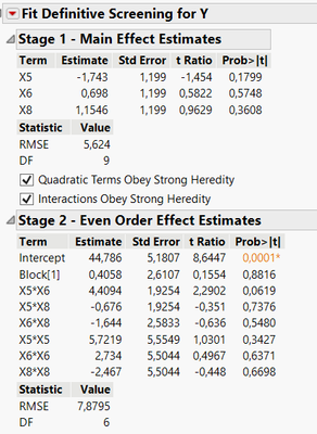

When using a random formula to model a response with this design, I have no error and can continue the analysis :

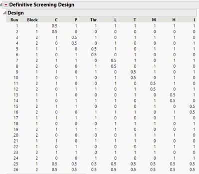

I have the same design as you (you can also find it attached) :
Normally you would get this error message when one or several experimental runs are not part of the design and destroys the foldover structure, see https://community.jmp.com/t5/Discussions/How-can-I-add-extra-runs-into-the-designed-runs-from-Defini...
There are many other ways to proceed with the analysis using the Fit Model platform if necessary, using Stepwise models, Generalized regression models, etc...
But in your case, row 18 is perfectly fine and is the "mirror image" of row 17 in the same block 1, so the foldover structure is present and respected.
Did you change any factors values in this row (or in others) after generating the design ?
Did you try launching the "Fit DSD" platform from the menu (menu DOE, Definitive Screening, Fit Definitive Screening) ?
Can you share an anonymized version of your dataset and design ?

Hi Victor,
I did make some changes to the table:
1. I sorted the data table ascending by block for organization
2. The experiment in run 19 I had to remove due to it failing before I could collect results.
would either of these have threw off the DSD design?

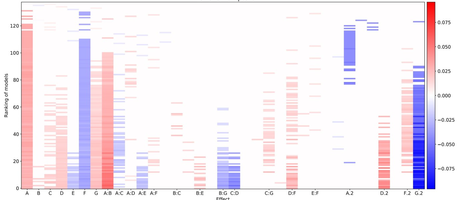

I particularly like the "All Models" option in the Stepwise platform (for limited number of factors and terms in the model), not to directly create in a brute-force approach the "best" model, but to guide the understanding and evaluation of several models, and choose the most likely active terms in the final model. This can be visualized through " Raster plots", introduced in the context of model selection for DoE by Peter Goos, proposed in the JMP Wish List : Raster plots or other visualization tools to help model evaluation and selection for DoEs
This visualization helps to identify the most likely active terms, and see where/how models agree or disagree. It can also help visualizing aliasing between effects. Example from a use case by Peter Goos :
@sanch1 At the end, "All models are wrong but some are useful", so it's always interesting to try and compare different modeling options, and even more when domain expertise can guide the process. Some methods are more conservative than others, but combining different modeling with domain expertise can help having a broader view about what matters the most. And from then, plan your next experiments to augment your DoE, confirm/refine/correct your model, and prepare some validation points to be able to assess your model's validity.
