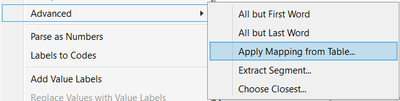

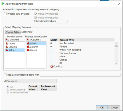

For this case, just add a mapping to get the right subset, e.g. in Jarmos Code:
colMapping = Associative array({{"SEX","SEX"},{"NAME","NAME"},{"A09:05","A"},{"A01:01","A"},{"DPA05","DP"},{"DPB04","DP"}});
colIndex= colMapping[col];
dt_dict_subset = dt_dict << Subset(Rows(dt_dict << get rows where(:Column == colIndex)), Selected Columns(0), Invisible);
Alternative idea:   There is a functionality in Recode which gets quite close to what you want: Apply Mapping from Table
At the moment it doesn't have a setting to specify the right subset. So, if you apply such mappings regularly  - and other users do as well - you might want to post a wish in the Wish List to enhance the function by such a setting ...
